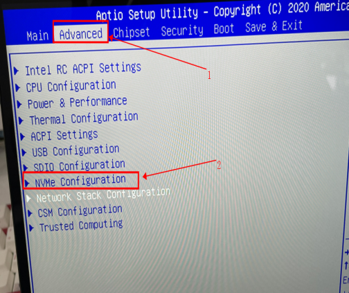

How to deal with the problem of automatically entering the BIOS interface when starting up?
1.You can check whether the SSD is recognized in the BIOS.
2. In the BIOS interface, find the options of SATA Configuration or NVMe Configuration (you can refer to the picture), and check whether there is an SSD storage device after entering the
options.
3. If no storage device is detected, that means the laptop has not recognized the storage device, which is an issue with the SSD.
4. If the SSD is displayed, you can download the Windows system installation package and try reinstalling the system.
5. If the issue was not solved after reinstalling the OS, it might be a SSD related issue, you can unplug the SSD and clean the pins, if the problem persists, you can try replacing a new SSD.
